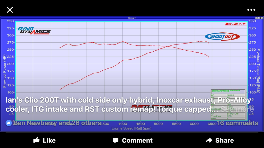

Offline Womble
#5 Posted : 19 June 2017 22:30:11(UTC)
Womble
Posts: 559
I have one on my car, then I am on my 4th intercooler, works really well, airtemps are a couple of degrees down on standard so runs about 4 deg above ambient. On a power run it cools very well and its recovery is very quick. My car runs 280 bhp on this intercooler.

#7 Posted : 20 June 2017 20:57:29(UTC)
Familyman
Posts: 172
womble do you think theres only really a gain in power when the standard cooler is struggling?
in other words with similar engine temps and similar intake temps would standard and aftermarket coolers make the same power?, or do you think the after market cooler will always make more power.
Can we take that graph on face value, does the new cooler always make 10 more bhp or was the standard test conducted with a very hot cooler which then makes the difference look much larger than it actually is, when compared to a cool engine on a cool day with a better cooler.
Ive just learnt to be cautious with power claims.!
edit
womble 280 bhp....have you changed turbo charger to make that power?

#11 Posted : 29 June 2017 19:16:47(UTC)
Womble
Posts: 559
edit
Standard 200 turbo with cold side 220 Billet wheel, Proalloy RS Tuning intercooler
