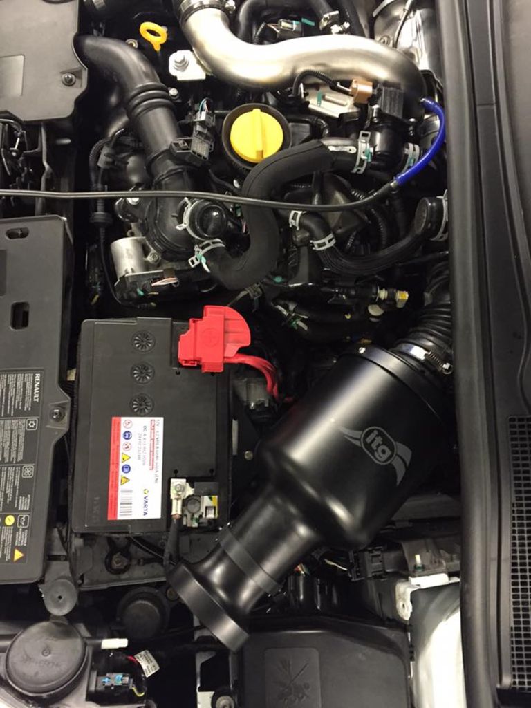

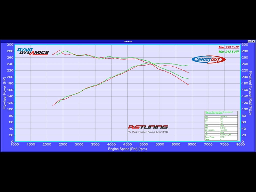

You want the ITG Maxogen kit, it will fit on your rubber intake pipe, as both air boxes are the same part no. The Turbo housing on the 220T is bigger so the alloy trumpet that fits on the turbo is bigger as well, but the airbox is still the same. We have seen huge gains with the ITG on the 200T.
As you can hopefully see in the picture it fits straight onto the airbox pipe.
While we only gained 5 bhp peak power, if you look at the end of the graph we gained 15 bhp over the stock airbox with a performance filter fitted, no adjustments were made to the map, these were back to back runs, in a controlled experiment.

Thanks Womble. This is useful to know, but as far as I can see the Trophy airbox pipe is the same bore all the way through. So I am struggling to see that the ITG would fit it?

You might be ok, if you look at the 2 pictures and the position of the sound pipe and the intake pipe end circlip on both pictures, it may fit. No promises.

I have just test fitted the ITG to my own 220 Trophy and I can confirm they fit perfect!
